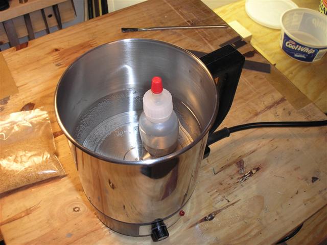

Dan, What kind of glue pot did you get? Here's a pic
of the new one I got off E-bay.It works real nice and keeps the temp at 145.

yeh dan, I hope you didn't buy one of those expensive glue pots. If so send it back, I got the Hot Pot at walmart for $9 with tax. It wasn't the rival one everyone recommended, but it looked exactly like it. Keepes my glue at 145 at about 1/3 of the dial..
